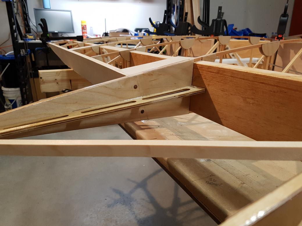

    I agree. The glue joint is perfectly acceptable. The wood failed before the glue. If you have gussets to hold the two pieces together then the glue between the two pieces is mute. The strength is in the gusset. On my wing I had one butt joint that didn't have gussets. The aileron spar butts up against the rib. While not called for in the plans, I used a couple of dowels to tie the pieces together.

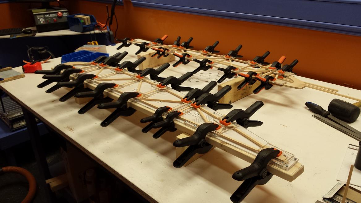

    The other question about sanding. I used birch plywood for my rib gussets. The plywood is shiny smooth. I used 80 grit sandpaper to rough up the surface of the plywood so the glue had something to adhere to. A lot of people use plexiglas for the rib jig. The secret there is the shiny smooth surface of the plexiglas. T-88 sticks but not well and can be easily removed. Rough up the plexiglas surface (from multiple uses) and you'll start to have a difficult time cleaning off the glue.
    You only need to use staples if you are going to pull the rib out of the jig before the glue is set. You can make multiple ribs in a day that way. You can staple through cardboard and remove the staples once the glue is set. The cardboard is so you don't mar the surface of the gusset. You can also leave the staples but they just add weight.
    I made one rib a day in the jig and left it overnight for the glue to set. The next day I flipped it over, added the gussets on the other side and made a new rib in the jig. That way I had plenty of time to coffee with the locals when they showed up to critique.
