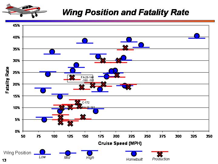

    I'm doing one of my periodic deep analyses of homebuilt accident statistics. One aspect is comparing the fatality rate for specific homebuilt aircraft against their configurations and cruise speeds. This is an example of the type of graphic I'm looking to update:
    Configuration is easy, but cruise speed is arguable. Below is my initial input to the analysis. I got them through a simple Google search. But I'm sure some folks here know better, and am interested in some feedback.
    I realize this is awkward, in that some types of airplanes (such as the Kitfox) have a range of models with a commensurate range of cruise speeds. But I don't need absolute accuracy...plus or minus 10-20 MPH is just going to shift a point on a plot slightly left or right.
    I figure it should be a popular topic. You get to argue about your favorite planes, plus you get to call me an idiot for some of my values. :-)

    Hmmm....this is why I post questions like this, because other folks come up with investigation lines I haven't considered.
    My theory is that high-wing aircraft have more structure around the occupants' head and upper bodies, thus their fatality rate is lower. My results generally seem to bear this out.
    If it's correct, though, biplanes should be the safest.
    So...what are some common biplanes? The Pitts immediately comes to mind. There are 71 Pitts accidents in my 1998-2016 database. Note that these are Experimental Amateur-Built aircraft; I don't include the certified versions.
    I type "Pitts" into the search function, and it tells me the Pitts has a 21% fatality rate. This is better than the overall rate of 25%...but I really expected it to be better.
    I typed in "Christen Eagle", and was shocked: 37% fatality rate.
    What the hey....?
    Then I took a closer look at those fatal Christen Eagle accidents. There were 13 of them...and almost half of them (6) were due to maneuvering at low altitude. Low level acro, for the most part. Maneuvering at low altitude has an extremely high fatality rate.
    In addition, three MORE fatal Christen accidents fall into a category I call "Failure to Recover"...started a maneuver at a high enough altitude, but for some reason didn't recover before ground impact.
    So the Christen comparison isn't too fair...they have a lot of accidents in modes that most homebuilts don't operate in.
    Oddly enough, when I took a closer look at the Pitts, the number of cases of Maneuvering at Low Altitude/Failure to Recover were almost the same as the Christen...nine and three, respectively. Plus it had only two more fatals than the Christen. This is interesting, since the Pitts saw more than twice as many total accidents.
    BTW, both aircraft have a "Maneuvering at Low Altitude" rate more than three times higher than the general homebuilt population.
    Stardusters, on the other hand, have a fatality rate of about 15%, much lower than average. Only eight fatalities for 55 accidents, but half of them are Maneuvering at Low Altitude or failure to recover. However, one case was builder error, in that the elevator weld gave way during a low-level roll.
    Anyway, good thought, and I'll incorporate it into my analysis.

    1,936
    Forgive an 'uninformed' question. What is the definition of 'fatality rate"? Number of deaths vs number of flights? Number of deaths in any accident? Certain accidents?
    My definition of Fatality Rate is the number of accidents with at least one fatality, vs. the total number of accidents.
    Just wondering. I'm presuming you feel there is a correlation between the location of the wing and general crash survivability? That would of course require comparing very similar crashes happening to machines with like mass/weight/velocity/impact angle etc? as well as wing location.
    Certainly, but unfortunately, that's difficult data to extract. Plus, of course, accidents are random events...a fatality might depend on whether the passenger is leaning over to tie his shoe, etc.
    I certainly understand I can't *prove* the theory that wing position affects survivability. I'm attempting to find some correlation by using thousands of aircraft in each configuration. The homebuilt accident record provides about 3800 accidents over the 19-year period my database runs.
    Obviously, the speed at impact is a very big driver...energy increases by the square of the impact velocity. I'm hoping to use cruise speed to differentiate...but, of course, few airplanes actually CRASH at cruise speed. I'm using cruise speed just to indicate the approximate operating range of the aircraft. An RV-6 approaches faster than the cruise speed of Frank's Nieuport, but by using cruise speed as the factor the difference in capability is acknowledged.
    One drawback is that there ARE no quantities of high-performance high-wing homebuilts. There are a few Aerocomps, even fewer Stallions. So it's hard to get data in the higher-performance regime.
    There is some correlation in the production-aircraft world. The Cessna 172 has a fatality rate of 12.%, while the PA-28 (through the -181) it's 19%. The Bonanza and the Cirrus both have rates in the low '30s, while the Cessna 210 is 20%. However, the 210 has a lot of landing-gear-related and fuel starvation accidents, which usually aren't fatal.
