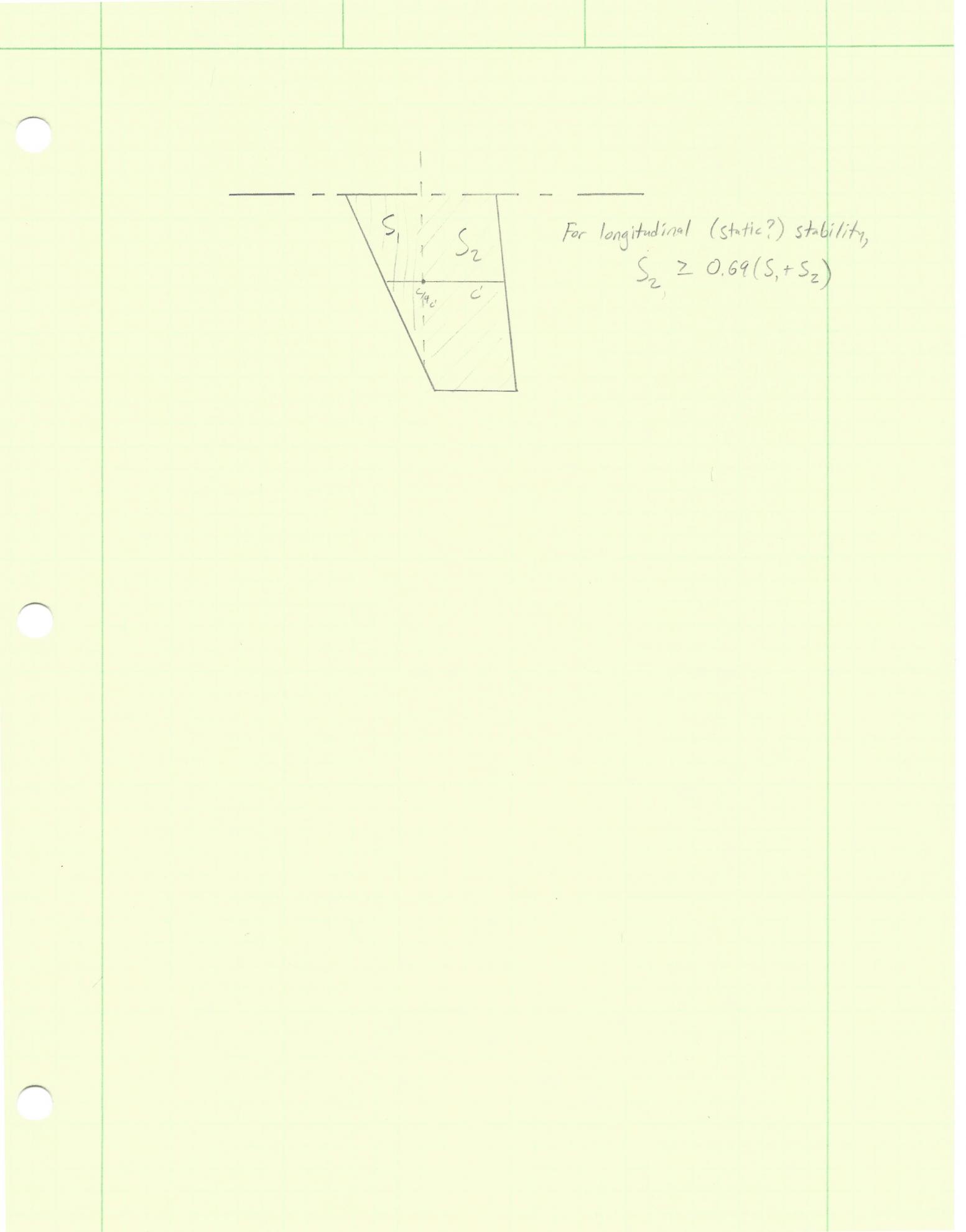

    The paper looks good. I was a little confused in section 3 about "the area behind the quarter chord point of the mean aerodynamic chord." I've sketched (half of the wing for) what I think is correct, can you check it and see?

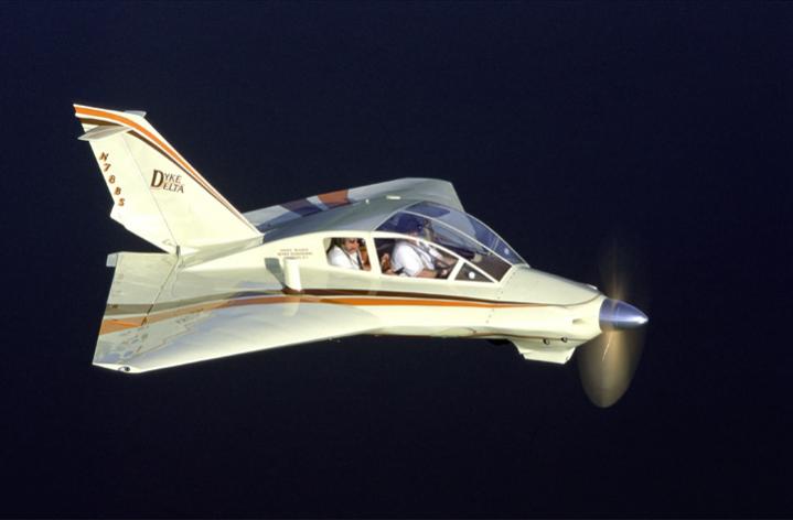

    Have you evaluated the A/B "Dyke Delta JD2" design that has been flying 55 years as of 2017 ? It is arguably the most successful of the A/B tailless designsName:  Jim Maher_Delta Builders Photos 075.jpg
