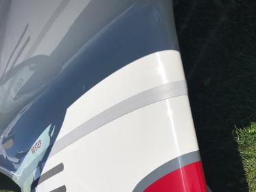

    I have seen this stuff on cars and planes in the past, including today at Oshkosh. However, no one I asked seems to know what the stuff is called, and hence its hard to nail down and order some.
    Here is an example of the material, likely PVC and being used here to seal a gap in the skins. Note this is solid material, not foam tape. Its also not Vinyl wrap (which is quite thinner than this).

    I guess what you are describing is something used by sailplane owners. Its called GAP SEAL TAPE. Here's an outfit that I have shopped at:
    Cumulus-soaring.com They are in Minn or Wisc. Scroll down on the R. side of the page and find "TAPE".
    Bob

    Thanks Bob. This is definitely closer, and addresses one of the needs (general gaps). I'm also looking for both formable plastics in the 100mil range, and a tape that is much thicker then the 0.14mm in Bowlus' version.

    White sheet acrylic is avaiable in various thicknesses and will form easily with a heat gun. Try home depot or similar and I think you can get it from aircraft spruce.
