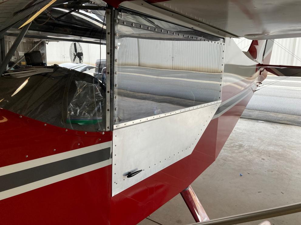

    New doors for the RANS S6
    I have an S6 with 100 hp Rotax. We recently replaced the all Lexan bubble doors which had cracked badly along the rivet holes, probably due to us not understanding that you need oversized holes. A mechanical engineering friend built us some 1/2 metal, 1/2 Lexan doors which weigh 7 lbs apiece versus 3.5 for the old doors. The new ones seal around the edges much better, are much tighter fitting and quieter. He'll make more for anyone who's interested. Name:  IMG_4179.jpg
Size:  91.6 KB HIs contact info is:
    Mike DiLuigi, <diluigim@bellsouth.net>.
