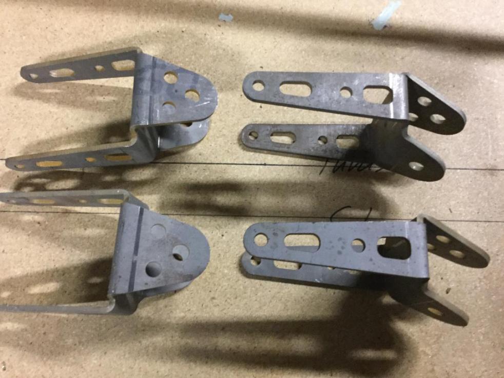

    So, not much else going on since I got an injury. Gonna take a while to heal since I tore my hand open down to the tendon. UGH. Here are the upper spar brackets for the D VII I got from John. Beautiful, and there were the last set. I will have to clean up the edges a bit and primer them but they are in a ziplock in my office till then. Score. The lower spar brackets are 90 degree bends which I should be able to handle pretty easily, (already have a working bending fixture that I proofed already) hoping to get back on them once I heal up.
    I do owe John lunch when I see him because of a payment snafu. He was very patient while he waited. Thank you again John.

    Myself... Since it's aircraft... I would have rounded the edges before Bending it with the Brake.
    Since it wasn't... I'd look very close for any micro cracks from the bend.
    Especially the over 90 bends...
    Just my too sense....02

    IIRC, these are all mild steel, so the chances of cracks are small.

    Any crack at all can Travel...
    On a larger scale , I've broke 5/8 steel... Even though I prepped the edges...
    When I bent it... It snapped so loud I thought the machine broke.
    I only mentioned it in this case because: aircraft and over 90 bend
    Gotta Fly...
