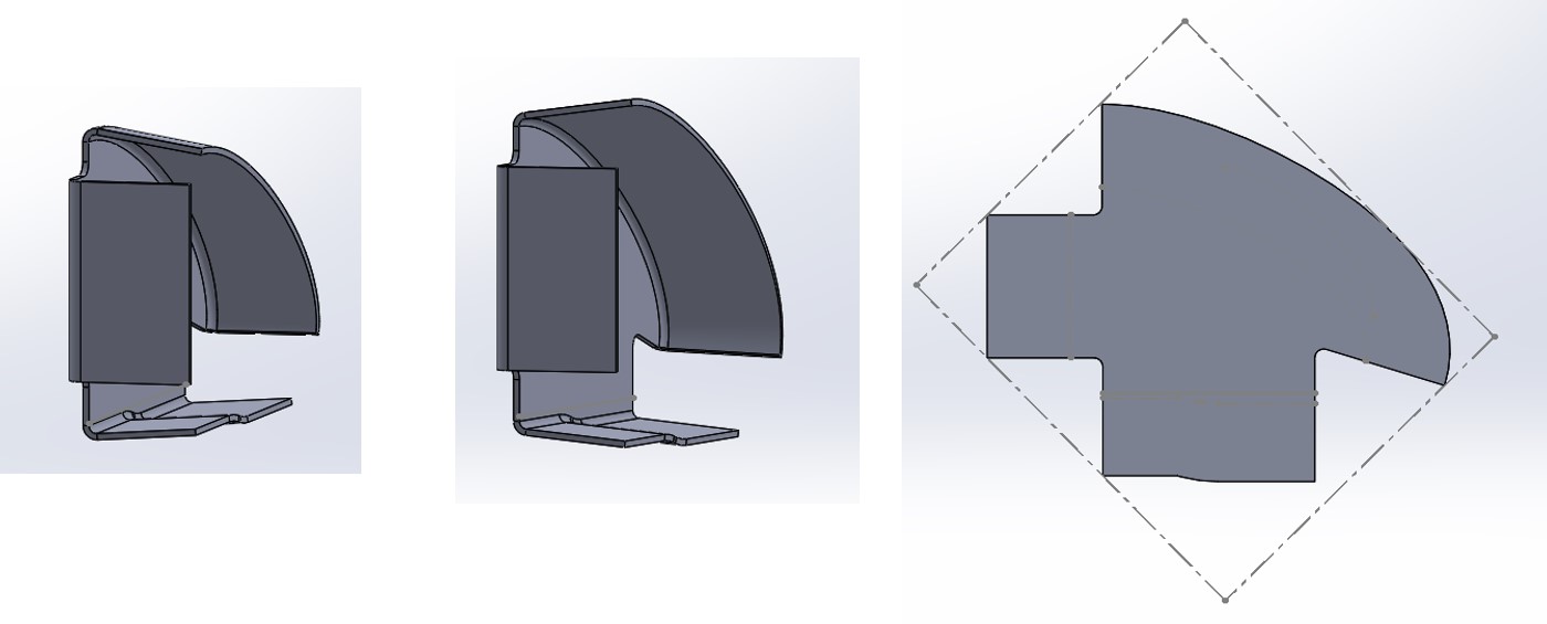

    Ha! I got this. Here is a made-up nose rib that is modeled 100% with edge flanges. The curved and joggled flanges will bend either direction from 90 degrees. It flattens! What I discovered:
    1. Curved, spline flanges will work if you start and end it with a flat line that's tangent to the curve. It only needs to be microscopically tiny, but flat.
    2. Joggled flanges will work if you limit the radius and length of the flange. Limits I found: .025 sheet metal, joggle for a .032 spar, with tangent arcs of max .4 radius, with a .47 inch flange. Lengthen the flange, and the arc radius must get bigger. Bust these limits and it won't flatten. These results are not out of reason - it would be hard to actually form a rib on a bending block much tighter than this unless it's annealed.
    I'll stop wearing you guys out for awhile now!
