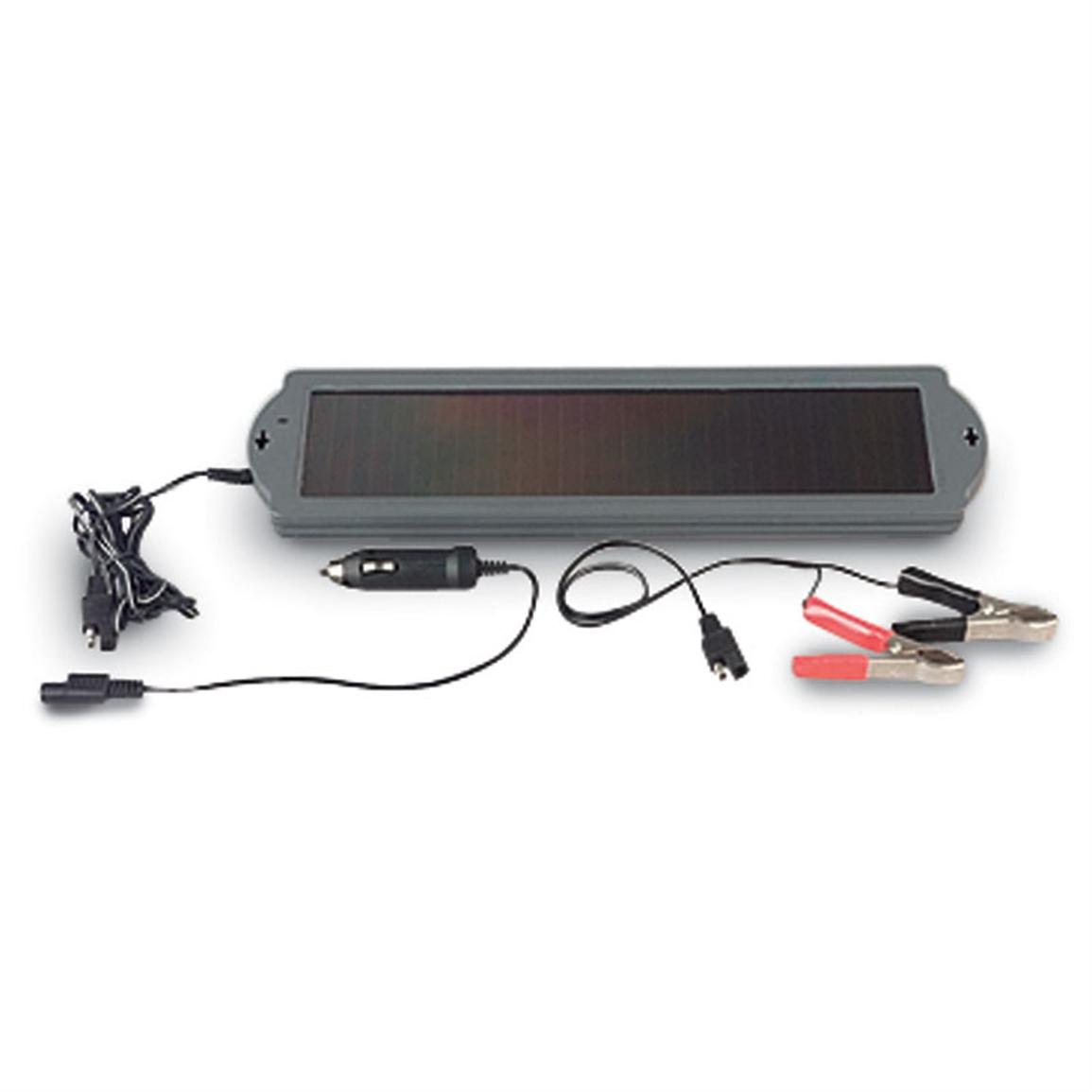

    Battery charging. Like, trickle charging? Not jump-starting.
    Wire in a cigarette lighter connected through a fuse directly from the battery, not through the master switch. Mount it where it's convenient to power your handheld radio or usb converter or whatever else you'd normally plug into your cigarette lighter. Yeah, I know, cigarette lighters are so old school, but some stuff still plugs into them. Like the plug from a battery charger.

    If you're just connecting a battery tenderizer then a cable like the one shown in the previous post works fine. I've got those little things dangling out of all sorts of things around here (golf cart, lawn mower, infrequently used pickup truck, airplane). If you want to do a higher rate of charge or even to something that is going to allow you to "jump start" the plane, then you're going to need to go to a larger connector such as the traditional aircraft APU plugs.

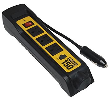

    FWIW: I cut the plug off this 150W DC to AC power inverter and connected it directly to the battery via a 10A fuse. Then I permanently installed it behind the seats for easy access even while in flight.
    I then took the plug and made a connection cable that attaches to my battery charger. When I want to charge the battery I connect the cable/plug to the 12v power port on the inverter. The 12v power port works without having to turn the switch on/off so it is about as fool proof as you can get. Besides being able to easily "trickle charge" the battery up to 10A, it provides a 12v DC power port, three 120v AC outlets for small devices and has a 5v USB charger all without having to turn the master switch on. The best part is that it looks very professional.
