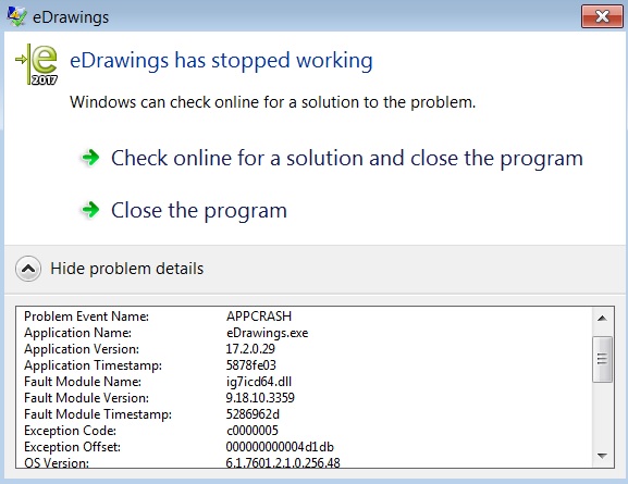

    I have installed the EAA Solid Works student version, but the program locks up when I try to open it. Same thing with eDrawings viewer. My computer uses Win7, Sp1, and seems to meet the other system requirements. Has anyone have an idea how to get it to work?
    The attached picture shows the error message when I cancel the program.
    I haven't heard of this issue before. What do you mean by "seems to meet other system requirements". With other software programs, I've encountered similar errors when I have too many programs opened. It could also happen if you're at or below system requirements.
