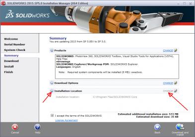

    How do I specify a different installation directory, and different data directories for / during installation?
    I am using a SSD for my C: drive and do not want to use it for this application?

    Quote Originally Posted by Mike_G View Post
    You can change it in the Installation Manager. See attached image.
