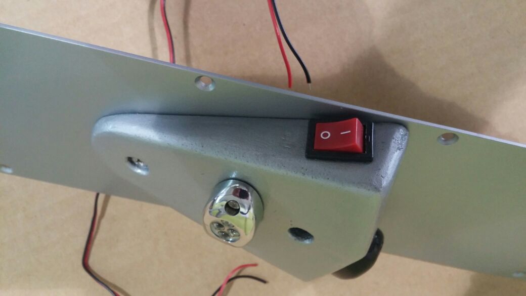

    In the spirit of this thread ...
    Here is an overhead light fitting designed in SW, 3D printed at home, and being installed on an RV. (Couldn't attach the SW part file - forum attachment file size limitation).
    Designed in SolidWorks
    3D printed at home (apologize for the poor photo quality)
    Being installed on an RV

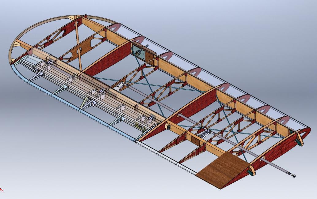

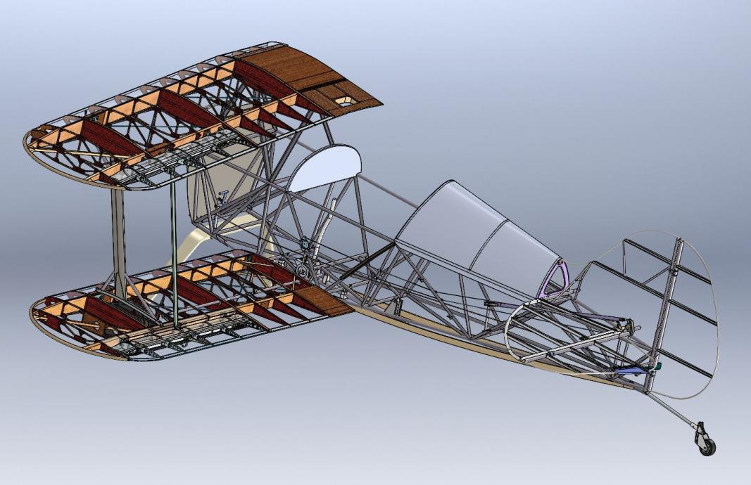

    I am not looking to share this model but several of us do share common stuff -- AN hardware, etc and the link to the library is on the Biplane Forum website. Anyway, the image below is of a Pitts project I started many years ago and will finally be putting on the front burner. This model started out as simply the aileron control system and I was looking to modify the geometry to eliminate the differential travel. I'm using different ailerons so a lot of things changed and the goal for me was to evaluate what the travels would be with stock or near-stock components and then change the bellcrank angle to get identical travels up and down. The aileron system model progressed into also looking at my elevator trim system,,,, then a full fuselage (modeled as-built since it pre-dates Solidworks) with wings. I started this model in June 2013.
    I'm working with an engineer on my aileron design and we communicate via email with Solidworks models. Makes life much easier for both of us!
    I have been a Solidworks user since 1998 and I see this as a tool to confirm that all the parts will play together nicely. I hope to avoid building multiple versions of parts only to find out I didn't think of all the downstream effects of my changes. The scrap pile should be smaller and pixels are much cheaper than aircraft materials. Beyond that I design the jigs and fixtures used to make some of the parts and some of those have already been built.

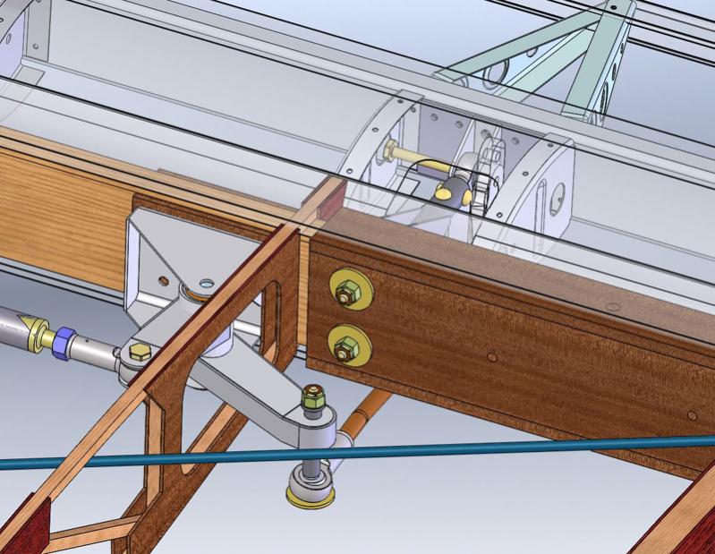

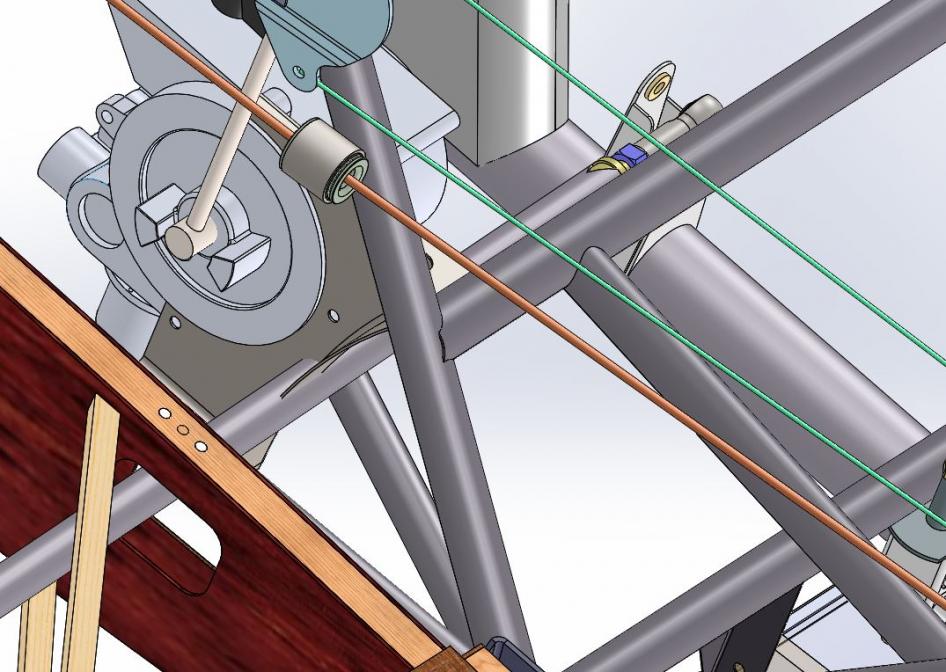

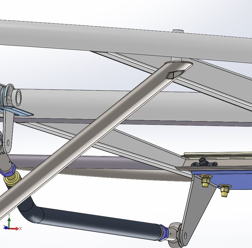

    Thanks Anna! Here are a few closer views;
    The bolt is not fully inserted because I wanted to see if it could be inserted past the horn.
    Name:  Aileron Cove, Lwr Tip9.jpg

    cwilliamrose's Avatar
    Nov 2013
    SW Florida
    217

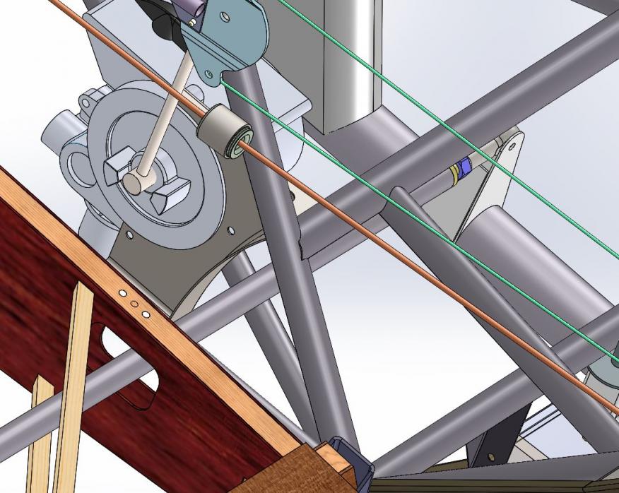

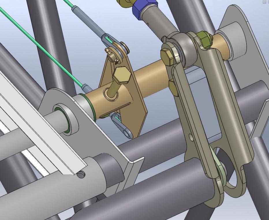

    To illustrate how I use this tool (SWx), I discovered an interference between the wobble pump bracket and the aileron pushrod. The aileron arm on the torque tube was (and actually still is) in the standard location but since my seat is farther aft the wobble pump is also farther aft. The fix will be to move the aileron arm (yes, cut off the old one and install a new one, straighten the torque tube, etc,,,) farther aft on the torque tube. On a stock S-1S the aileron pushrod is not parallel to the spar, mine will be (when I get around to changing it). I wish I had a tool like SWx when I did the initial design work, a mistake like this would have never happened...
    Name:  Wob Pump Brkt Aileron Interference1.jpg
    As currently built.
    Name:  Wob Pump Brkt Aileron Interference2.jpg
    Post surgery.
