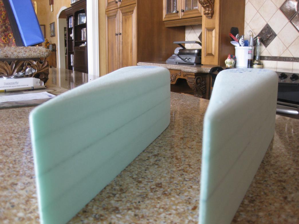

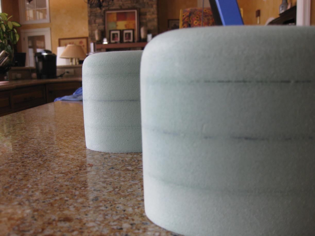

    I sanded and radiused the edges of the tips. Here's some views:
    Given these shapes and edges, would it be reasonable to try to lay the BID down as one piece against the tip end and then smooth out over the top, bottom, and leading edge? I know BID is somewhat conforming, but didn't know if I'll have huge wrinkles that won't smooth out.
    Or, perhaps cut an airfoil-shaped piece that overhangs the tip end all the way around, smooth that down, and then lay a strip down that wraps all the way around the top and bottom surfaces of the tip? If I did it this way, guess I could try to stagger the overlaps of the multiple layers to avoid a large "hump."
    Finally, I've also been advised the best way to deal with the trailing edge is to just let the top and bottom 'glass trail-off over the trailing edge and then after curing, go back and trim and fill any voids with flox and resin to fuse the top and bottom surfaces and can also be shaped for a nice clean trailing edge.

    I would try one piece. Work carefully taking your time. If you end up with a wrinkle, no worries just let it cure and sand out the spot with a wrinkle and on the second layer work to ensure you don't have a wrinkle in the same spot. You will need at least two layers anyway. I think the trailing edge will be your biggest challenge as you have to terminate the cloth and make an edge. I would consider making the edge, a glass to glass. You can do this by not doing your initial layup to the trailing edge top and bottom but rather having it end on one side about one inch short. Then, after curing sand back the foam so that some distance is left with just the cured glass. Then on the next layer take the glass to meet against the glass that you sanded to. This creates a good finished edge. Looks great so far, keep us up to date on the project. I want to see how it comes out.

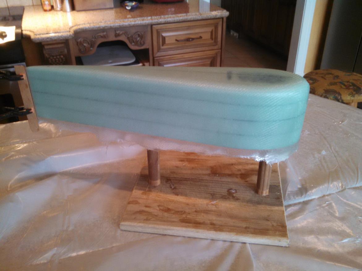

    Well, Todd, I gave it a shot today and I think it worked out OK!
    I coated the foam with micro slurry and then laid down 2 layers of BID. There was indeed a large wrinkle on the leading edge that I just couldn't work down, so I slit it up to the apex of the wrinkle and overlapped the slit edges. On the second layer, I worked the wrinkle into two wrinkles - each lateral to the overlap in the first layer. Then I slit those and overlapped the edges. So, I wound up with 3 overlaps all in different locations, so no big "bump" or build-up. I think a little sanding and filling and it'll be fine!
