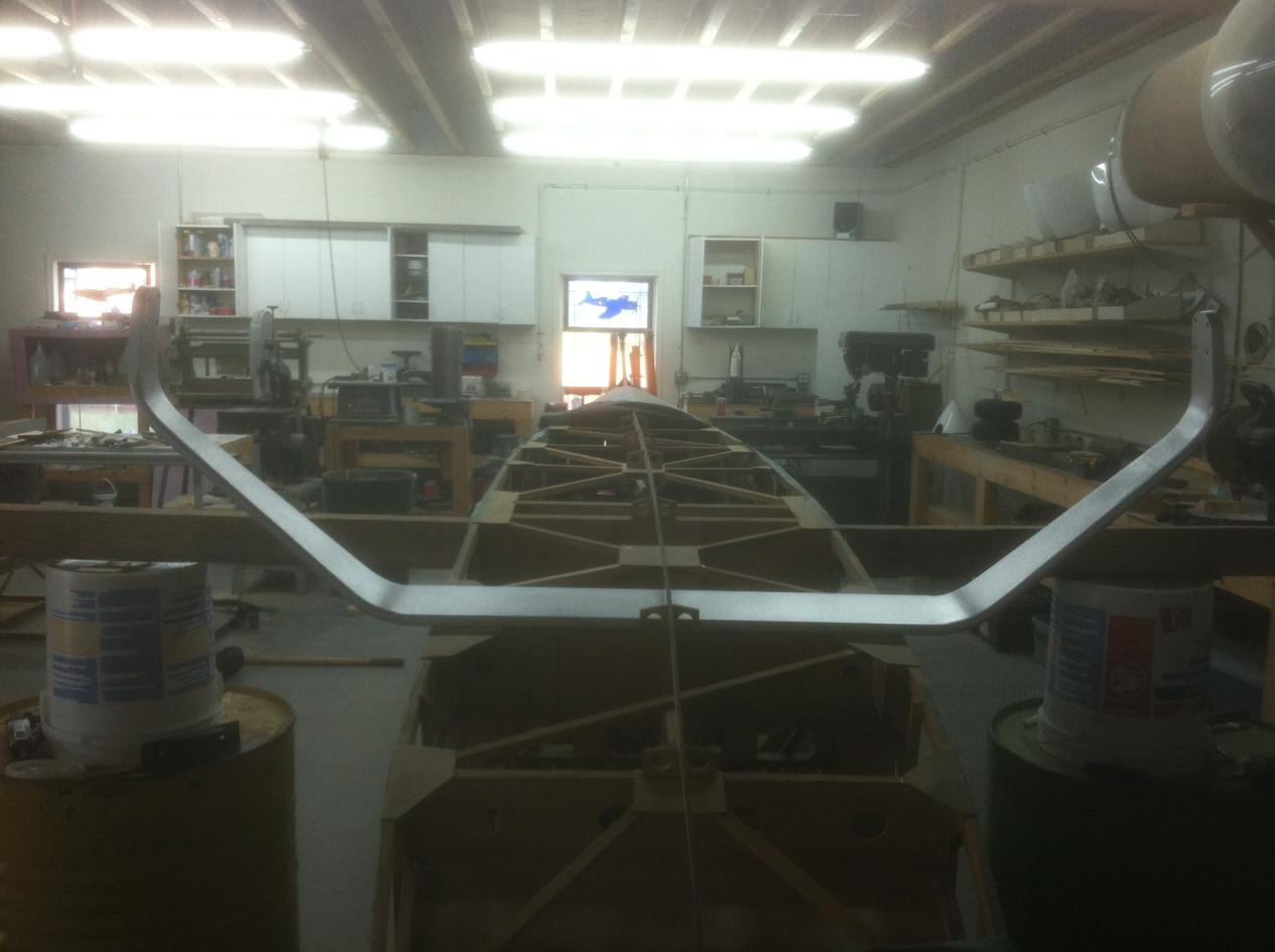

    Just a quick note to let everyone know whats happening with the Robin. I got a nice note from Norm Langlois who was concerned that something might have befallen me!! Well I went to the airport for the first taxi tests and I discovered a problem with the landing gear. My design , using a spruce wood core and carbon pultruded flats started to crush under the clamp stresses and taxi stresses. As a result the gear started to slide outward. We noticed it immediately and stopped all taxi testing. I took the Robin back to my shop and pulled the gear. Bottom line is, I ordered a brand new Aluminum spring gear from Grove Manufacturing. I am not giving up on the idea I had for this gear, but a one piece aluminum gear is a known entity and represents one less variable. I am making modifications for the new gear to the Fuselage. I will be back in air in a few weeks.

    Thanks Norm for your concern. yes, i am finally making some progress. My new landing gear came in from Grove Aviation yesterday. I'm still waiting for the radius block clamps, so I can finish the gear installation. I have uncovered the fuselage and rebuilt the local gear attach frames and bulkheads. I decided to add the gear external to the longerons, rather than though the fuselage as the previous gear was installed. I will redesign the final gear installation to clean it up a bit, but this is a very clean redesign for the existing structure. Here is a picture of the gear sitting in place:
