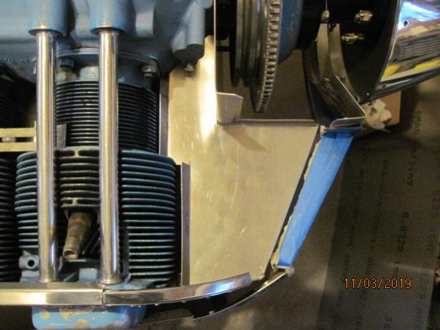

    I've got the back wall cleco'ed to each side , still more to go

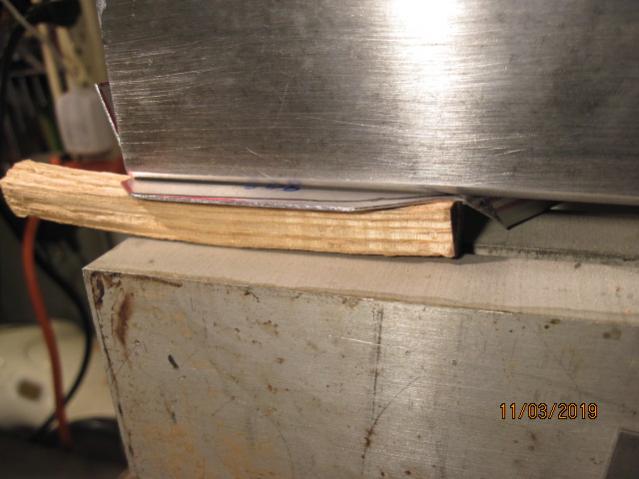

    218

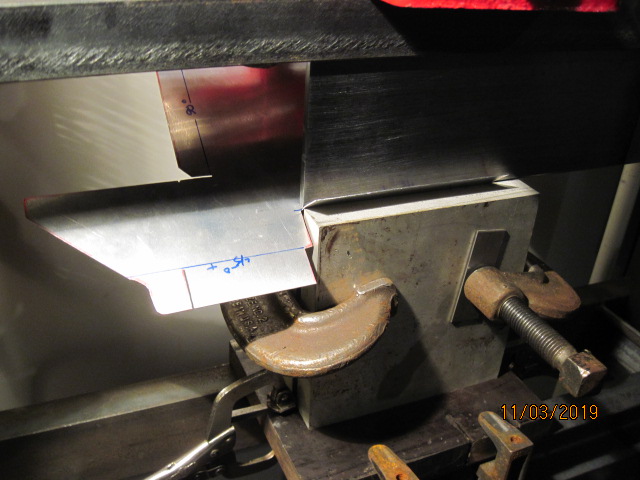

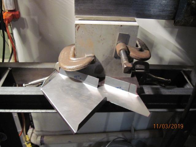

    funny bends took funny brake pieces

    here's the piece in place , still a rough fit

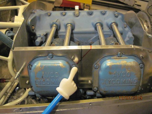

  4. #54
    Brrrmidji , Minne-SNOW-ta
    218

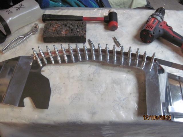

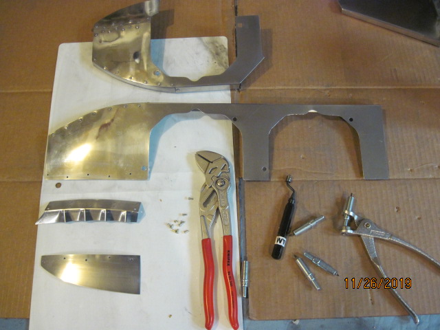

    more paper turned into aluminum
  5. #55
    218

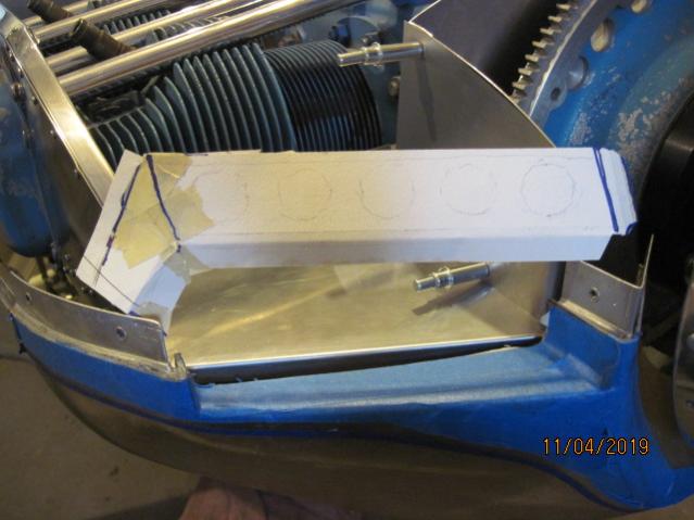

    Any thing wrong with cutting this here ?
    I drew the black line first , I like the straight cut the red line is showing .
    Sealing it... Small piece of aluminum to overlap and a little bit of high temp silicone to make a vulcanized sandwich.

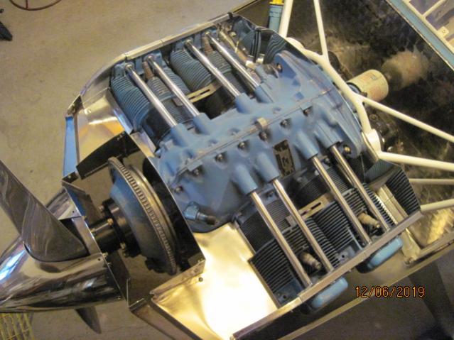

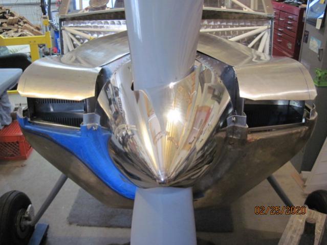

    Baffling - Daylight
    More Baffling Pictures.
    I have Dzus fasteners on a lot of this lower Plenum.
    I plan to hold the top cover in place with them too.
    So far...the lower pieces weigh 2 lbs 4 ounces
    It's strong and comes apart easy.
    I made a drill template for the Dzus lay-out...Banding material works good.

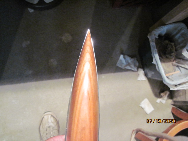

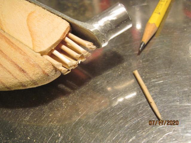

    218
    clear wing tips

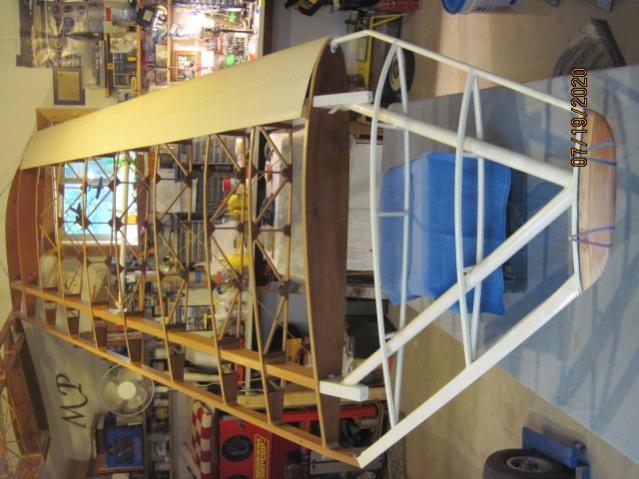

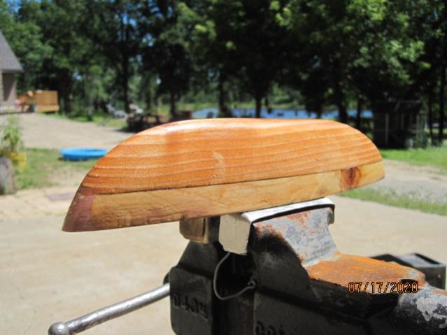

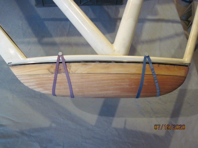

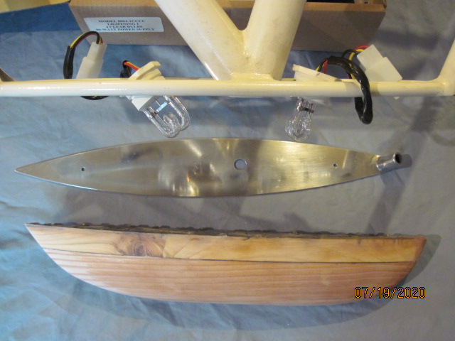

    hmmm, I stuffed the Buttercup in the pole barn while I work on my Kolb FSII.
    Then an opportunity to vac-u-form my wing tips / strobe cover came up .
    I looked through my old experiment , found a piece that I can use ...after a little bit of repairs
    Here's some pics ...They might have been formed last night , I'll post those pictures later.
