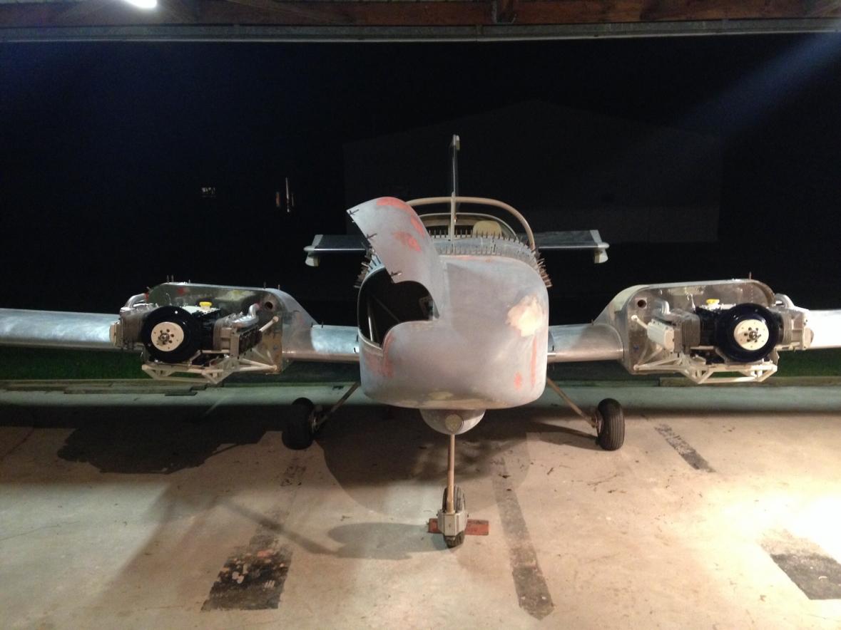

  2. #22
    75
    Front view of engines mounted temporarily.
    Measure it with a micrometer, mark it with a grease pencil & cut it with an axe.
  3. #23
    2,560
    It seems very hard to believe that just stopping an unfeathered prop cuts 94 of the drag, or else it would have been used in other planes, cheaper, simpler than feathering.
    Obviously, once you get to flight testing you can, at a safe altitude, shut down one engine, brake the prop to a stop and try it, and you will know how it flies on one engine. A premium would then be on getting the brake off and restarting.
    It may work, but I'd sure wear a chute and be able to get out. A chute won't help if an engine is lost on takeoff,though.
    You sure have put some work into it.. Good luck.
    Note, I am not any kind of expert on this, and don't even have a multi rating.
