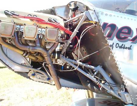

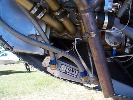

    I have the Sonex/3300 3-into-1 outlets. I wouldn't be surprised if they are using the exact same tubing combination of OD x wall as on the muffler you're having trouble with, because they fit really loose and leak like crazy. I tried wrap, but you know what? If you don't stop the FLOW, wrap just gets blown through and burned up (something about that 1300-1400F exhaust gas). I believe wrap can truly insulate to the SURFACE temp of an exhaust pipe, but when there's flow, wrap is hopeless. It just turns to charred ash and falls away, and you're back where you started. So you have to stop the flow.
    Someone on the Sonex group mentioned chimney cement - not sure how much jaustin's Wurth's stuff is, but chimney cement is about $3 for a little tub at the local airplane supply (hardware) store - enough to do 100 airplanes' worth of exhausts. But the little tub will dry up and turn into a brick-in-a-can before you can re-apply it next year... It's a ceramic product, which means it's crumbly, and will probably just turn to dust and fall out of the joint after a while. But it's cheap, easy to apply, and does seal the pipes.
    Any comments about "reducing the back pressure" - well, that's like putting your thumb in the dam. Say you reduce the back pressure by 2psi, when there's 100 psi coming out, how much flow did you reduce? If there's leaks in the joint, it's gonna leak (big) under the cowling regardless of whether you have 10" or 3 feet of tube between the leak and the outlet. Stop the flow is the name of the game.
    Practically, though, for how short the Sonex 3-to-1 outlets are, I wonder why they are separate parts, other than to make the engine easier to fit into their shipping crate. Anybody just weld it all up and be done with it? The old "log" style headers used to be that way - just 1 all-welded collection of tubes per side. Here's some photos I took of the factory Sonex/3300 back in 2000. Exhaust = 1 piece per side, so it can and has been done.
