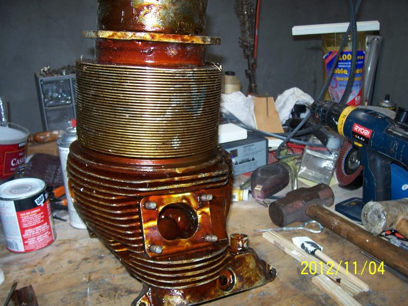

    Can anybody Identify the cylinder pictured? The bore at the base as nearly as I can measure is 5.004 inches.

    Sure looks like a Pratt. Take another bore measurement. A 985 is a touch bigger.

    It can't be a 985, you have to be looking at the rear of the cylinder in this picture. If it was the front of the cylinder you would see where the pushrod tubes mount into the front of the rockers. Also the Pratt 985 doesn't have those large radius curves in the fins near the plug hole, that detail is very unusual. The Pratt has the exhaust exiting the cylinder at the rear, this one exits on the left side of the cylinder in this picture, you can see the studs. And the 985 has cylinder hold down studs evenly spaced around the base, this one has 2 on each corner.
    Please post another picture or two.

    That is a Wright cylinder.......for a tank engine. It is not an aircraft cylinder. Continental Motors built R975's under license during WWII for tanks. How would you like to cross Europe listening to that thing run......HUH? What ya say?
