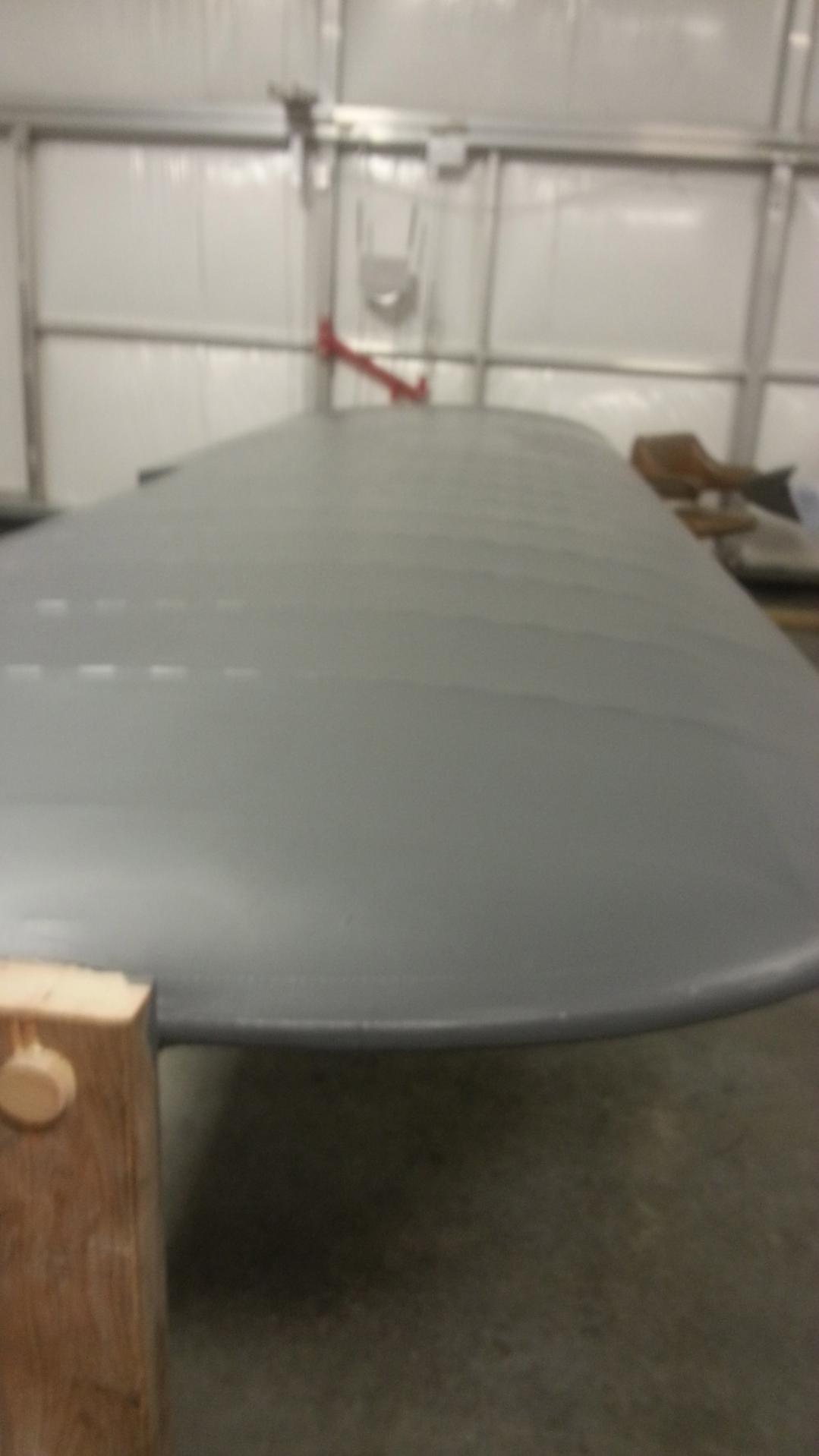

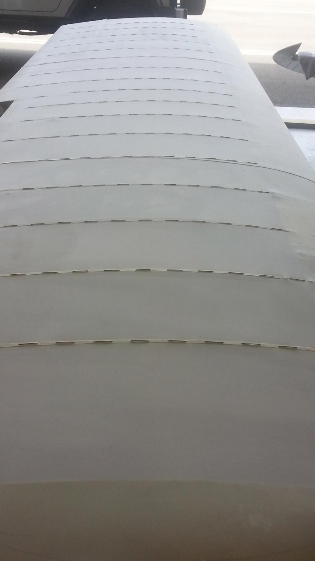

    I just finished my 170 wings with Ecofil and it looks great.
Size:  89.0 KB Name:  20131028_132943.jpg

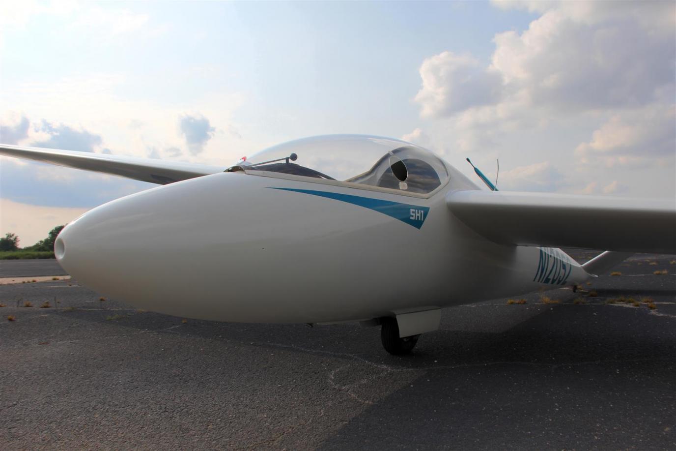

    If you have 30 years of experience spraying paint, I can see why the Stewart Systems paint would give you trouble...it sprays very differently from auto paint and the Stits products, but if you follow the directions, it works. I've also found the people there to be extremely helpful when I called searching for solutions to issues I was having. Every time it wasn't working right I was doing something wrong, and they were able to guide me in the right direction.
    Name:  Austria07 (Large).jpg
