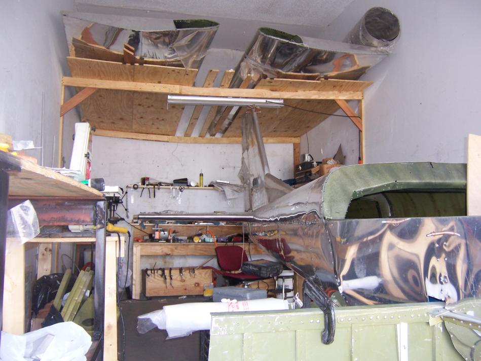

    I am building the Sprint ws202. Pictures of original plane on the net. This is a 2 place low wing all aluminum plans built. Does anyone know of another bulder of this plane. The wings minus ailerons, fuselage, tail feathers are pretty much done. Corvair engine will be installed 1st quarter 2012.Name:  shiny.jpg

    There is no support for this plane. The Designer, Bill Spring, decided not to support this plane 8 years ago. I am working off the 11x17 study plans I bought from a Canadian. Final plans were never offered There are plans out there and no one is building the plane other then an Austrailian, Max, bought Palani' project http://lpalani.tripod.com/ and me. Bill Donig in Canada bought Bill Springs Sprint and that is it. You would have to make every part. While I agree it is a great plane and I am glad I started it 6 years ago, no one flew a Sprint in 5 years. 2012 will have me and Bill flying. Unless I find this flies great I would caution you to start. But yea, it is a great looking plane and thanks.

    I was a newbe to building. I thought with, it seemed, about 10 people building and the list on Yahoo (long gone) I would get help and learn from others. It did not happen, but I continued. The plans are good and detailed with a few errors. You are given xyz cooridinates for ribs, bulkheads. The wing was no problem. The bulkheads were a little off so the skins were cut over size from the plans and then trimmed. The landing gear,pain, are reversable for tail or tri. I don' worry about competition. My plane will look good and strong, but not a show plane. I would like to see other Sprints so I will see if I can find someone to sell you their plans. Other then copying a page or two. I won't sell or give my plans. As for parts the ones I have left are the bad ones that have to be made over. I believe that I have made two bad copies for every one that is good. Happy thanksgiving, Joe.
