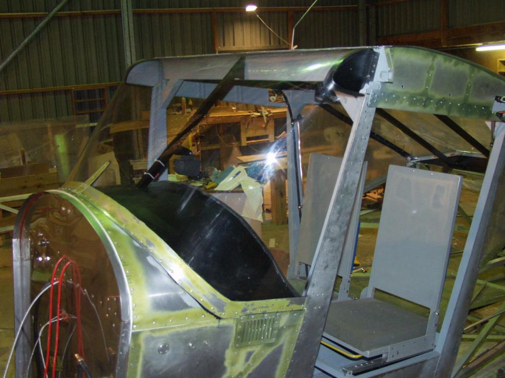

    I've had a bit of experience with Polycarb windscreens - including how not to do it!
    My Own design Adventurer has a very large polycarbonate windscreen - cutting it out flat takes a good percentage of an 8 x 12 sheet. It is also quite tricky in that the fuselage side cant outwards, so the bottom edge tucks in tighter than the top!
    This was made out of 3mm Polcarb and was cold bent into place - retained by a flange on the door pillars and secured by the trim fairing around the base and angle strips inside. the problem is, I didnt do it right. The tight radius bends at the wing roots started crazing after a few months, and not long into the test programme the whole lot split open when I was taxiing in after a flight. a crack had propogated from the radius down to a small nick on the bottom edge. The tension held in a cold - bent screen is huge (it took two people to wrestle it in when I first fitted it) and this doesnt dissapate - it will be trying to pull apart throughout its life. When I replaced the screen I did things differently, and it appears as this is working better. With the replacement screen, I was meticulous about the surface finish of the edges - they were cut with a rotary cutter rather than a jig saw, and the edges were chamferred and sanded smooth with 800 wet and dry sandpaper. Before fitting, I had to hot bend it to remove the latent tension. This is really tricky as Polycarb will cloud if heated too quickly (It is hydroscopic and the water boils). According to the material specsheets, the minimum cold bend radius of polycarb is 100 x the material thickness - in other words, for 3mm it will be nearly a foot! for the top radius (Where it curves back into the fuselage top) I fount a large diameter steel pipe and clamped it in line with the start of the bend. At the free end of the bent over section I clamped a piece of timber to each side. The plastic covering was removed from areas to be heated (very important!). A friend and I then SLOWLY played two heat guns along the bend line - heating both sides at once, and constantly moving - never hold the gun in one place. eventually the weight of the timber started pulling the bend down and at the desired point heating was stopped and the panel allowed to SLOWLY cool. The side radiuses where the panel curves under the wing root were done using a similar technigue, but a steel bar coulnt be used since the radius varied from very tight at the top, to a large smooth radius at the bootom. I still used two heat guns, but concentrated on the tight bend area, and sort of "feathered" the heat application. When ready I Bent it carefully by hand, pressing the bend line wearing leather gloves. It wasnt perfect, but the latent stresses were essentially completely removed.
    As far as geometry goes. Mark up the curve profiles you need and divide the curves into equal divisions. Measure the distances between key points using a piece of string, and triangulate the screen from there - I got mine almost exactly right first time using this method.
    Another useful pointer is if you are transitioning between flat and angled, you can bend 3mm Polcarb in a sheetmetal folder and it will come out very neatly - this also stiffens the panel and reduces drumming. The rear cabin window on my aircraft was done that way:

    Oh, and in response to your original query, heres what I would do...
    Make it one piece - the top is a big enough radius to be cold bent, the side pieces can be bent on a sheetmetal folder. No joints to worry about sealing, nice and rigid and no need to try the tricky heat method unless you are that way inclined....
    3mm Polcarb will be fine - My screen is huge and only starts to shake at about 135kts - It is the limiting factor on my VNE!
