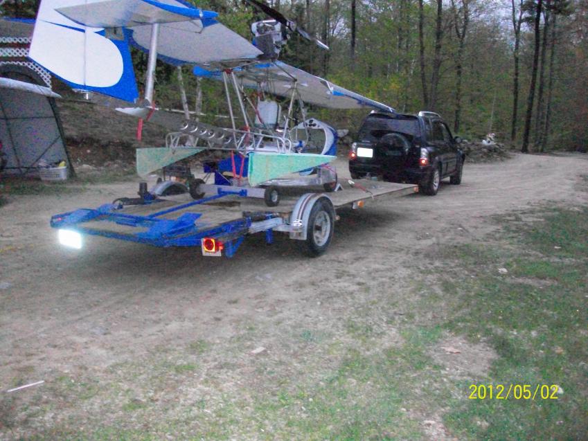

    Name:  new tail finished plane 014.jpg
Size:  96.7 KB Took the plane on its first road trip this year to work where the floor space permitted some weights and balance check. My boss like me LOL.
    The best news I can tell you IT QUALIFIES!!! weighing in at 287 # The rest isn't so good I have some work fixing the CG.
    I get right on that though .
    Regards ALL

    Tail heavy I presume. Where is current CG as a percent of MAC? For your weight ______ and for 140 pound 200 pound pilot?
  3. #33
    Norman Langlois's Avatar
    Northwood ,N.H. USA
    180
    The current CG was calculated with myself in the pilots seat I weigh in at 160# position was 39.7 % of a 68 inch MAC this is using the ailerons as part of the MAC. The wing plus the flaperons .Using the formula in the book Flight testing Home Built Aircraft. the point loads were taken with me on board.
    My coworker tried calculating the point by a vector analysis. that didn't. verify but, a actually lifting the plane with the fork truck with me on board put it exactly where the calculation said it was. About 7 inches to the rear. of the 30% point
    I have reconfigured the hang cage to accommodate an a adjustment . of about 6 inches to the rear wing and engine while lengthening the moment of pilot and hull and shortening the moment of the tail. This should be enough to bring it back into spec. I have had to argue this move already please don't
    Those who don't see why its the best option. Here is why. I can move three of the 4 major inputs to the balance but that's the best I can do.My people couldn't see that they just think move the pilot but why that's only one of 4 and requires greater distance and much rework. The wing and engine are in a typical pusher moment arraignment. The new tail and the fact that I moved the hang cage forward last fall are the real reasons for the falling out of spec. Pivoting the hang cage to remove the steep angle of attack resulted in the 6 inch wing forward
