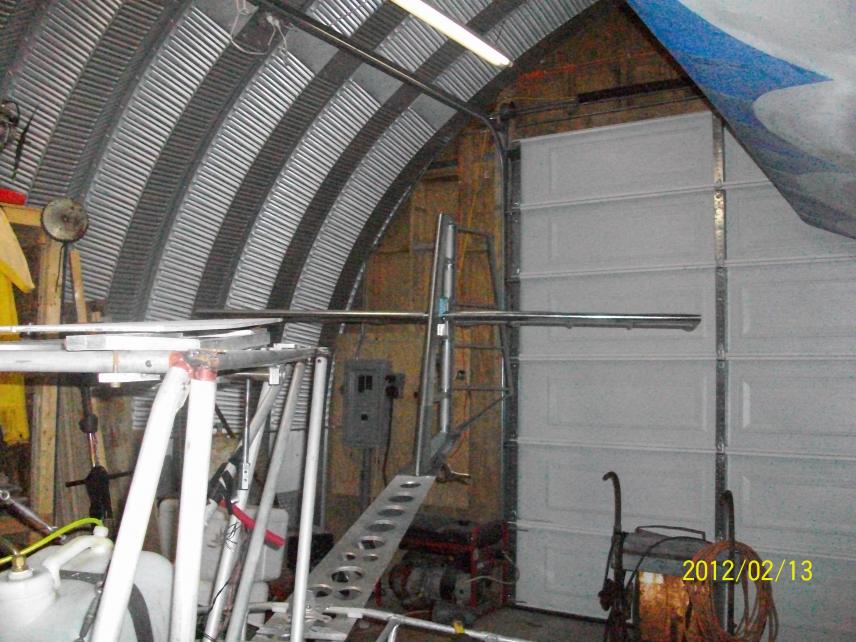

    A couple of pictures of the new tail configuration
    I just finished rigging the controls so now its time to detail things and get to covering
    A look down the air frame gives some Idea of the prop wash over the new tail the center of the prop is about 10 inches above the top of the frame. Ignore the object in the wing mount area its the pivot jack for the wing. looking only down the outer tube you will get the alignment described.
    In the old archives there was notations about wet tail the V-tail was so low it was in the water when no pilots weight was applied.Causing many undesirables. This tail will be dry even if the boom rests low, That will quickly drain away when pilot is aboard. This new tail features a stabilator and it is cantilevered.Also its in the negative lift configuration, being an none symmetrical airfoil. It is however easily reversed if necessary. I am expecting much better control this time.

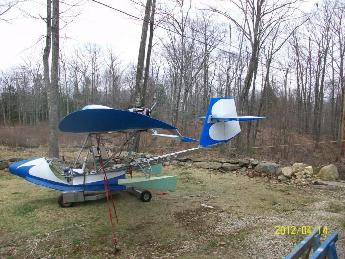

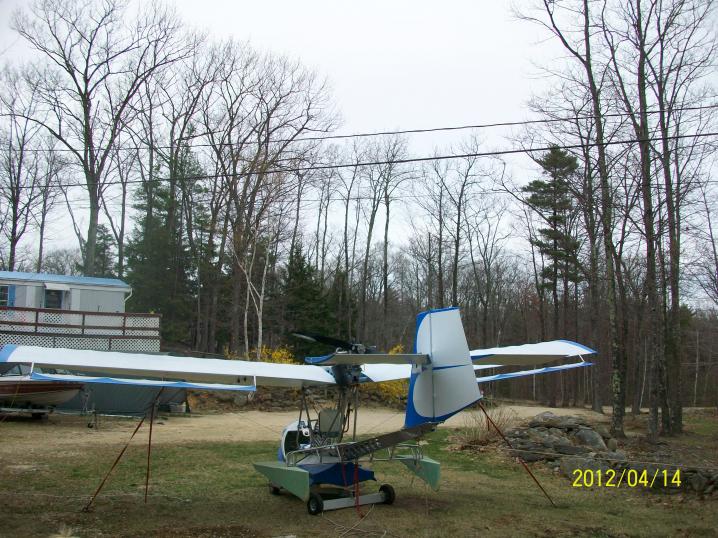

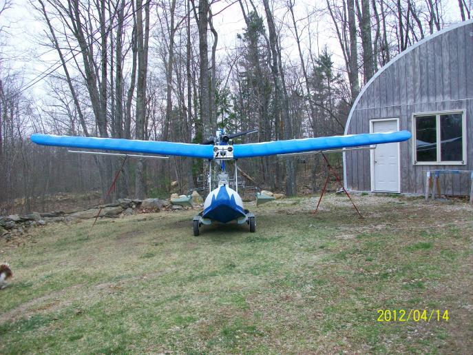

    Finished pictures with the new tail
    Winter is over and I am on track for spring trials .I am expecting first or second week end in May.First runs are just straight taxi runs working on and gathering facts . dont be expecting to see it fly for a while .I will post the results and videos as they evolve.Name:  new tail finished plane 001.jpg

    Do you think you have the clearance on the sponsons to rotate for take offf? Please let me respond before you do any attempt at high speed taxi, rotation or lift off. This could be a clasic case of an airplane that is difficult to rotate but once rotated it jumps off the ground/water climbs steeply and stalls at about 30 to 50 feet. Several have done that with fatal results. Mark Staul for the latest well known example. The airplane will fly at a slower speed than you will imagine once rotated.

    Yes Jedi I do think there is enough for rotation.I will take another photo of the front view and try to show the elevations. If you can zoom in on the frontal shot and note that the side shot show a bit of an angle of attack on the hull bottom.I think now with the wing at a 6 to 8 degree angle for rotation there should be no contact from the ruder portion of the sponson. A higher angle of rotation may spike in about 3 inches or so. Do you see that as being enough resistance to create issues.
    I have no intent to try flying yet, only straight taxi. The sponsons do not sport finish paint because they may need adjustment.
