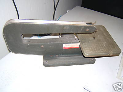

    Try to get your hands on an old, guillotine-style paper cutter like this one:
    I made over 1000 little 1X2 gussets with one of these. Cut your 1.2M sheet into long strips with a utility knife, then use this to cut the strips down to size. Look for an old, heavy-duty one.
