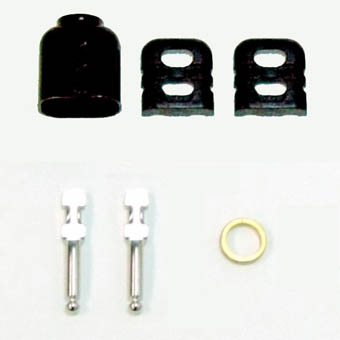

Seems like if polarity was important, they would have designed the individual posts differently. In this shot, they look identical
![Name: u173u.jpg
Size: 31.7 KB](https://eaaforums.org/attachment.php?s=af682c2da6f81cdfe7c220ccaa32d937&attachmentid=9533&d=1711409090)
Oddly, on another shot I took, the posts are actually different...but STILL not different enough for a polarization guide.
![Name: u172_2.jpg
Size: 55.1 KB](https://eaaforums.org/attachment.php?s=af682c2da6f81cdfe7c220ccaa32d937&attachmentid=9532&d=1711408956)
If you can, in the squealing cases disconnect the U173 and turn it the other way.
If it's an old fashioned carbon or dynamic microphone, polarity shouldn't matter. If it's a modern electret mike, polarity will matter.
