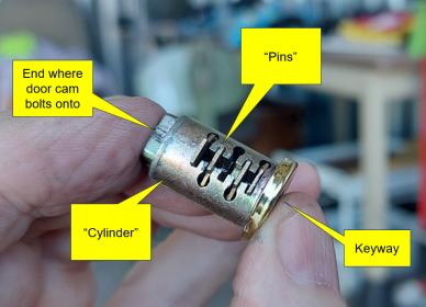

    Here's an illustration of the basic lock mechanism. The key goes in where my manly thumb is positioned. The other end is where the longer plate bolts into, that actually catches the door jam when the key is turned to hold the door in place.
    Name:  Screenshot 2023-08-11 235509.jpg
    It's all contained in a big cylinder. This lock has five spring-loaded plates, "Pins," in slots. They're real obvious in the picture. This cylinder goes inside a tubular outer housing. If any of the Pins are sticking out, the lock cylinder won't turn and hence the door is locked.
    On this very, very common type of lock, the pins are shaped like hairpins... they're open at the far end (the part not in sight), and have a little tab sticking up on the side closest to the camera (again, should be obvious from the photo).
    When you stick the RIGHT key into the lock, all the pins lie flush to the outer edge of the cylinder, and thus the lock will turn and let you open the door.
    When you stick the WRONG key into the lock, one or more of the pins will still stick out and will keep the cylinder from turning.
    In my case, two pins stuck outside the cylinder when I put the ignition key in place. I just used a needle-nose pliers and pulled those two out. And voila, it would now open using my ignition key.
