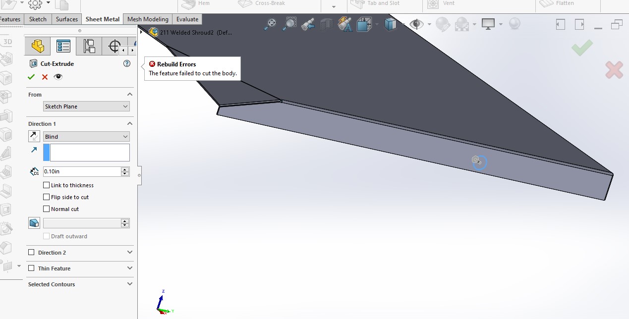

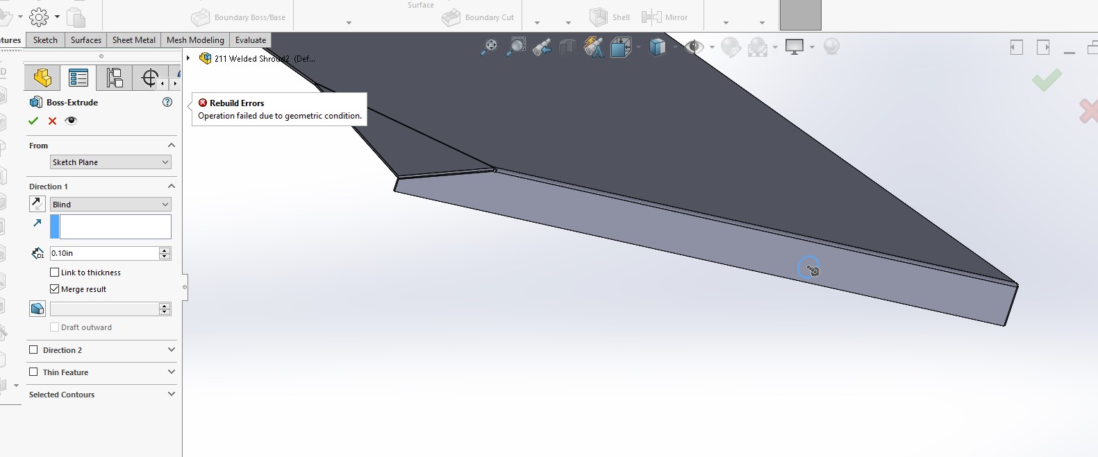

    I'm having difficulty with a radiator shroud I am trying to make. For some reason I can't seem to cut the hole in the shroud. I have tried placing holes on every surface of the shroud with no luck, I also tried boss bass and also no luck. Attached are examples of the errors I get when I try each operation.
    Does anyone have any idea whats going on here?

    Hello MB107,
    I can't tell looking at the 2D, but is the sketch of the circle on the planar face shown, or is on a plane that's more or less coincident to that surface?
    In the 2nd image, you should have gotten the error message (paraphrasing) "cut does not intersect...", but you didn't get that one. You got the vague one!!
    I see you're in sheet metal. I've noticed some weird changes to the 2019-2020 student version that makes sheet metal a lot more work than, say, the 2016 version. One thing you may want to try is to take the cut into regular part mode, but clicking the "Features" Tab. It might be easier that way.

    Yes the sketch is on a planer surface. I tried every surface on that part to put a hole in it and no luck. Then I tried placing boss bases on it and no luck anywhere. I finally remade the part and got everything to work but I have no idea why. Must have been some kind of corrupt file?
