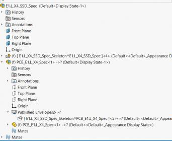

I am working on a new assembly on which I am wanting to try out the SW2020 Envelope Publisher for top-down design.
I have my basic envelope created. I have also published it to a subassembly so that I can reference the parts in that subassembly to the published envelope.
When I make a change to the envelope model, the change does not appear in the subassembly's published envelope.
I have tried using the rebuild command and the published envelope isn't following the top-level envelope.
What might I be doing wrong?
