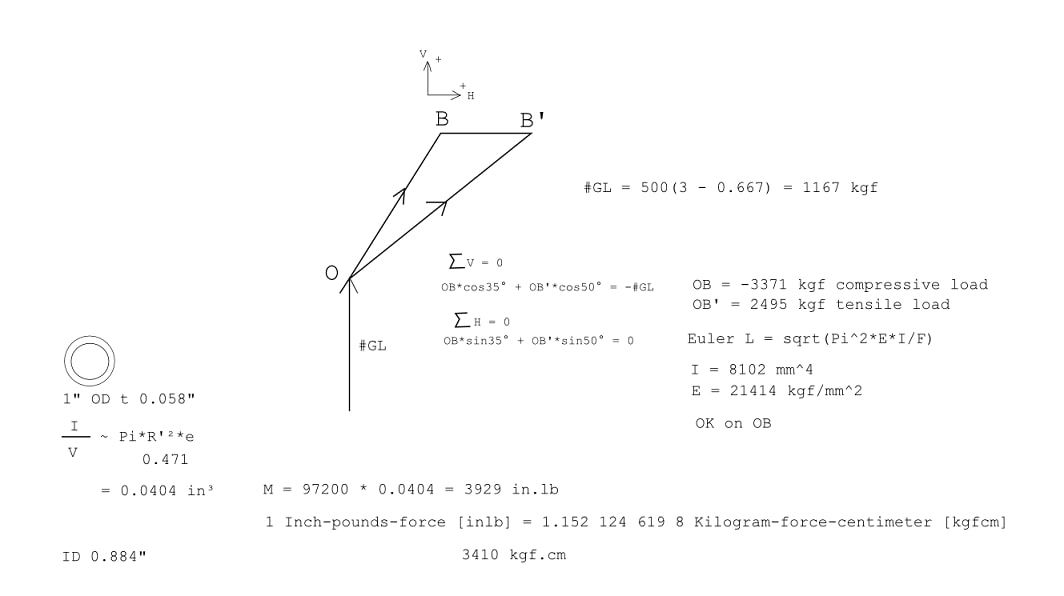

    In an all wood fuselage design similar to RagWing Roger Mann designs or Fisher Flying products
    I'm concerned with strength of undercarriage and dimension of bungee cord shock absorbers.I didn't
    found a lot of reference to help. I have the R.Hisckocks PDF that misses the Landing Gear Chapter and
    don't know if it could help. All advice is welcome, thanks.

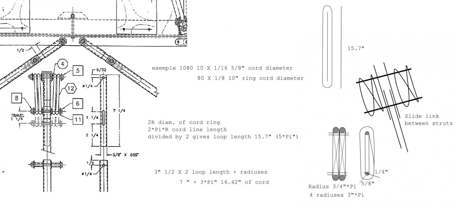

    A good description of shock cords is there
    https://www.univair.com/content/Shock-Cords.pdf
    Example with a 1080 cord:
