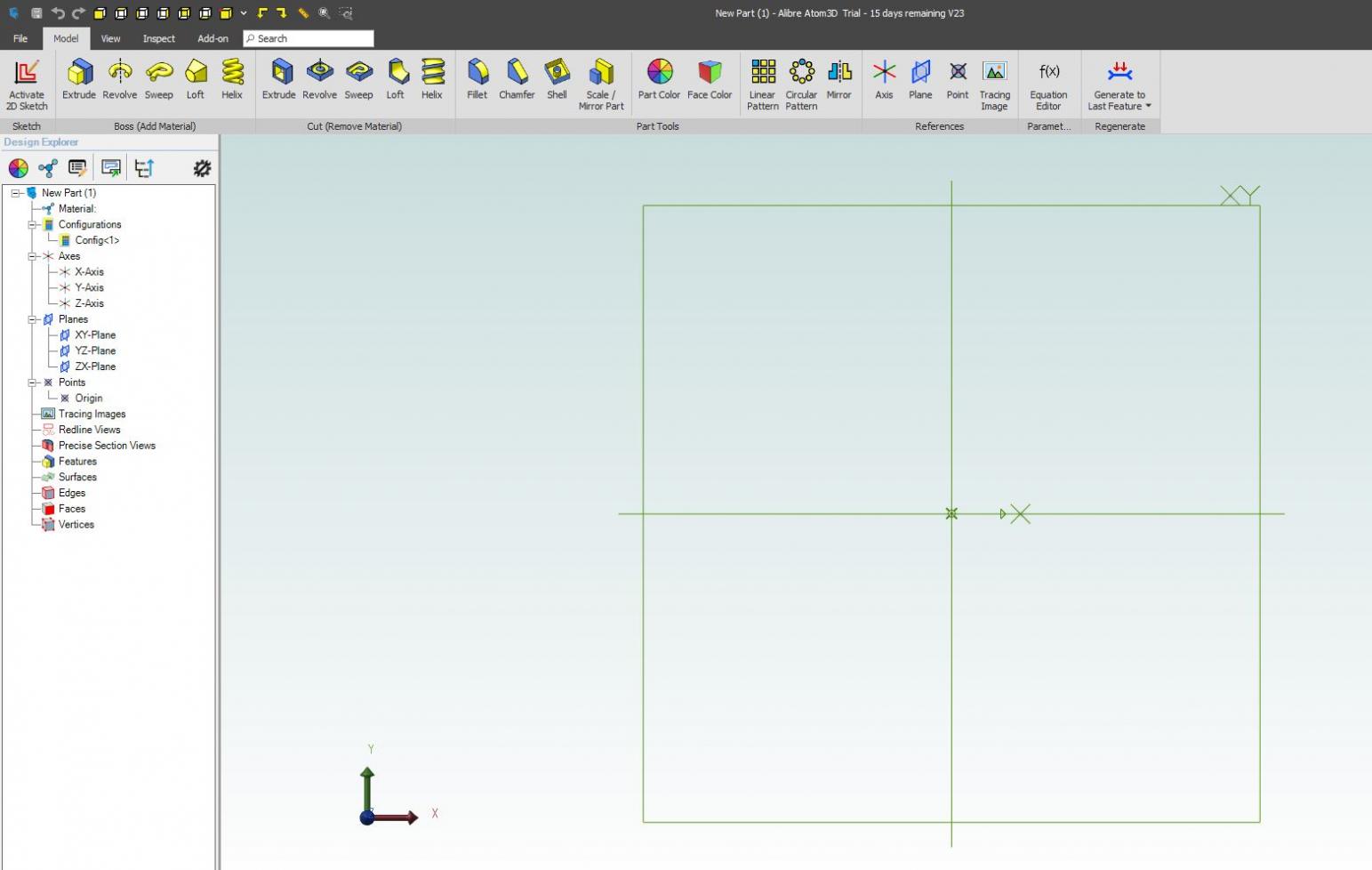

    Note that, for a Solidworks user, this was MUCH more familiar ground. The button icons themselves show familiar imagery; Extrude, Loft, Fillet, Chamfer, etc. They work similarly.

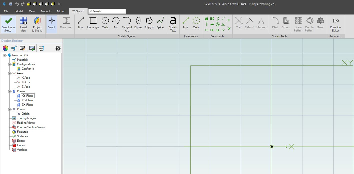

    Even better...note the "Activate 2D Sketch" button on the upper left. This exactly corresponds to the Sketch function in SW, and opens a new set of controls:

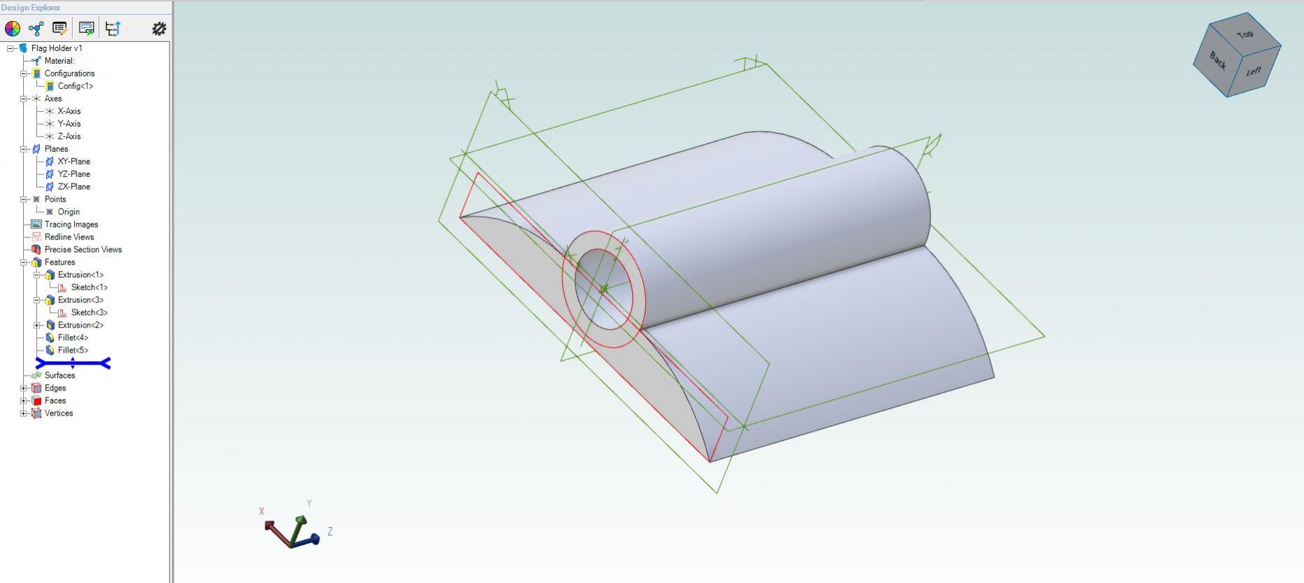

    Many familiar functions, working similarly to SW. In fact, I found it *easier* to manipulate the view of the part in Alibre vs. Solidworks.
    You can left-click and hold either the axial diagram on the lower left, or the 3D box on the upper right to change your point of view.
    I'm sure FreeCAD's a fine program, but I think for someone trying to transition from Solidworks, Alibre is a better option.
